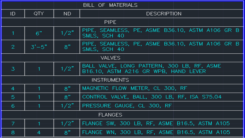

You can now display both in-line and off-line instruments in the BOM table in isometric drawings.

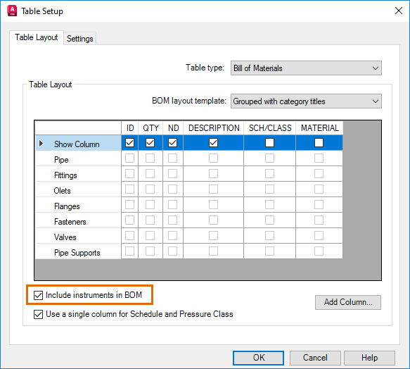

To include instruments in BOM from Project Setup
  1. On the Title Block Setup ribbon contextual tabTable Placement & Setup panelTable Setup.
  2. In the Table Setup dialog box, select Include instruments in BOM.
