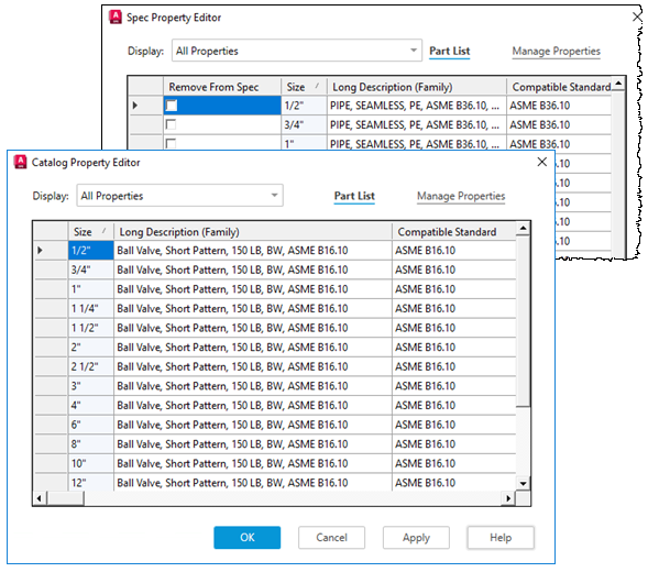

The Edit Parts and Edit Properties functions are enhanced in both Spec and Catalog Editors.
Edit parts within a selected parts family for inclusion in a spec sheet or catalog.

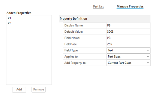

In a spec sheet or catalog, add and set property definitions for the following:
  • Selected part sizes or for the part family
  • Current part class or all part classes

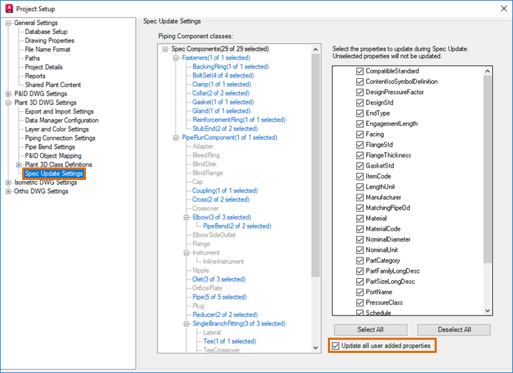

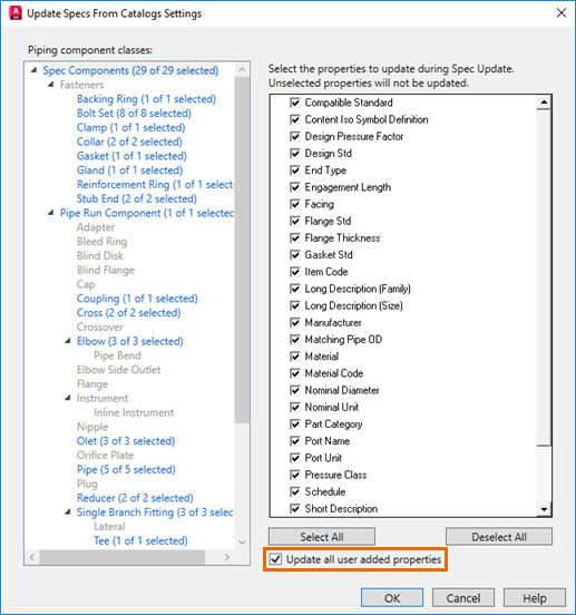

You can choose whether to update the user-added properties in the Update Specs from Catalogs Settings dialog box.
Note: The same option is available in the Spec Update Settings from Project Setup.

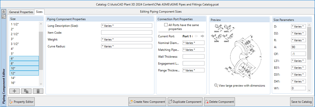

You can now select multiple part sizes to modify properties in the Catalog Editor.
