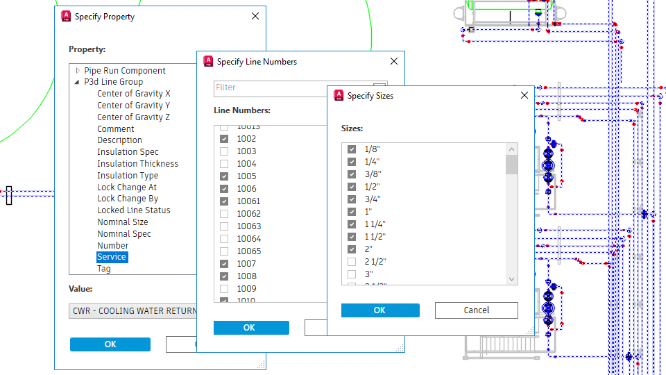

In this release, ortho single-line piping offers more enhancements including a new interface for some piping criteria providing better control when you display piping in a single-line representation in orthographic drawings.
In addition to the Command prompt, you can now specify the following options from the flyout menu.
  • Line number
  • Size range of piping
  • Property
  • Window selection

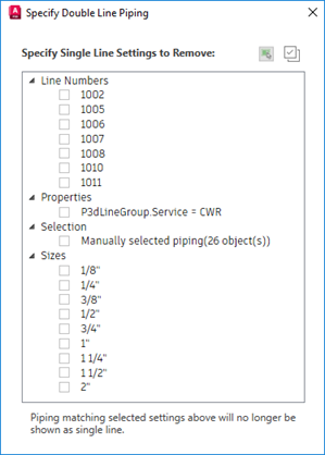

You can also specify double line piping when switching between single- or double-line display.
