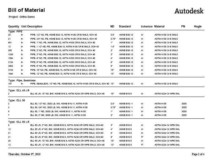

    • 3D Parts.rcfx
      Produces a Plant 3D bill of materials. See the sample report below.

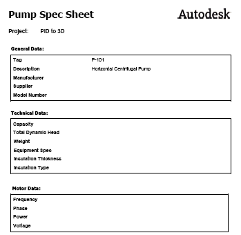

    • Pump Spec Sheet.rcfx
      Produces a P&ID spec sheet. See the sample report below.

  • Reports—by default, the reports are stored in the project folder. The configuration file determines the output format, but a designer can override this setting as needed.
    Here are two sample reports, the first is the 3D parts imperial and the second a P&D spec sheet, both in PDF format.
