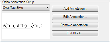

Annotation Format for Orthographic Drawings (Plant 3D Class Definitions Tree Node)
Assigns class, drawing, and project properties to a new annotation style based on an existing annotation style or modifies an existing annotation style.
Access Method
 Ribbon: Click Home tab Project panel Project Manager Project Setup Plant 3D DWG Settings Plant 3D Class Definitions node
 Shortcut menu: Project Manager Right-click a project icon Click Properties.
 Command entry:  projectsetup
Ortho Annotation Drop-down List
Displays the names of the available annotation styles for the selected model object.
Add Annotation
Displays the Symbol Settings dialog box, where you can add an annotation style.
Edit Annotation
Displays the Symbol Settings dialog box, where you can modify an annotation style’s settings.
Remove Annotation
Deletes an annotation style.
Edit Block
Displays the AutoCAD Block Editor, where you can edit the annotation behavior.
Note: If you are unfamiliar with using the Block Editor, see “Create and Use Blocks” in the AutoCAD Help system.
