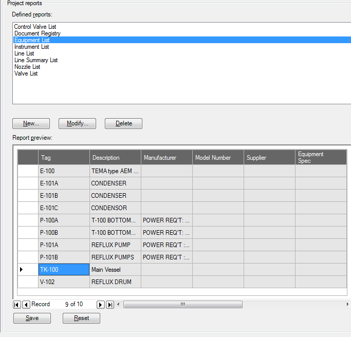

Defined reports
Lists the reports that users can view in the Data Manager.
New
Displays the New Report dialog box, where you create a new report based on an existing one.
Modify
Displays the Modify Report dialog box, where you can modify existing reports.
Delete
Deletes a report.
Report Preview
Shows the specified report as it will be displayed in the Data Manager. You can sort by clicking the column headings. Using the right-click menu, you can filter by the selection, by excluding the selection, or by specifying values.
Note:
Surround a string entry with single quotation marks (‘). Entries are case-sensitive.
Conditions (can be used cumulatively) Purpose Examples
Angle brackets (< >) to display values not equal to your entry
  • <> ‘700’ displays only rows with cells containing strings other than 700
  • <> ‘’ displays rows with cell data not equal to an empty string, thus eliminating rows with empty cells
Equal signs (=) to display values that match your entry = ‘Bosch’ displays only cells containing the string Bosch
IS NULL to display only empty cells Displays only rows with empty cells
IS NOT NULL to exclude empty cells Displays only rows with data
Save
Saves the preview filtering and sorting as the report view that the user will see.
Reset
Restores the report preview to the default view.
