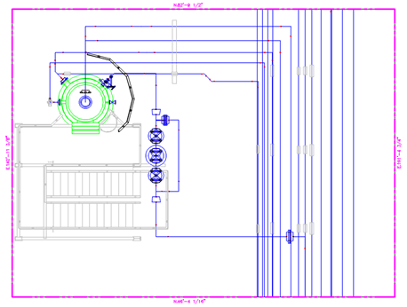

You can now display piping in a single-line representation in orthographic drawings according to different criteria.

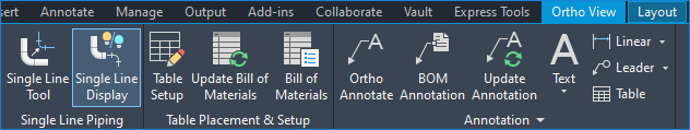

To work with ortho single-line piping, do the following:
  1. Click Ortho View tabSingle Line Piping panelSingle Line Display.
  2. At the Command prompt, select an ortho view to manage the single-line piping display.
    From the flyout menu, you can display all piping as a single-line piping or based on
    • Line number
    • Size range of piping
    • Property
    • Window selection
  3. Click Update. All specified pipelines will display as single line.
You can also switch an ortho view between single- or double-line display.
