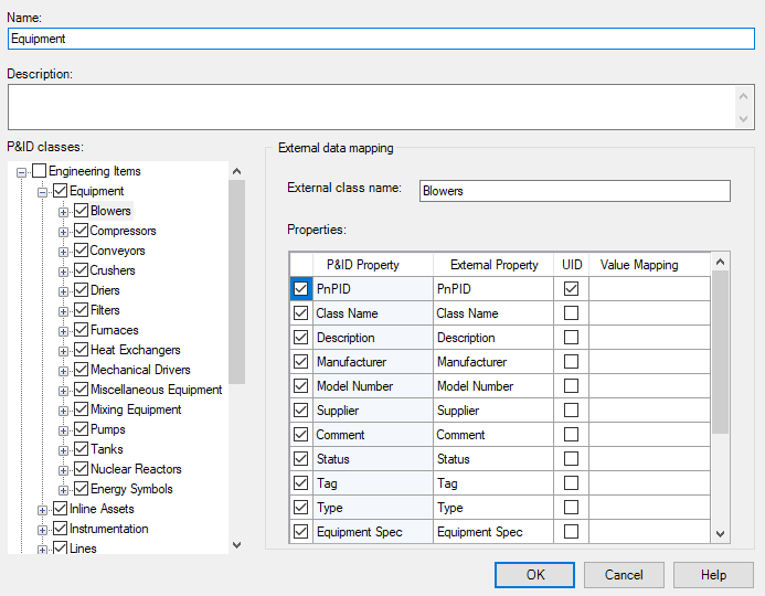

New Export and Import Settings Dialog Box
Configures a new export and import setting.
Name
Specifies the name for the new export and import setting. The name you specify appears as a selection in the Select Export Settings and Select Import Settings lists in the Export Data dialog box and the Import Data dialog box.
Description
Specifies a detailed description for the new export and import setting. The description appears as the tooltip for this setting in other dialog boxes.
Plant 3D Classes
Select Plant 3D classes to populate fields in the External Data Mapping section.
External Class Name
Determines the mapped class name. By default, it is the same name as the AutoCAD Plant 3D toolset class, but you can change the name to the external data class name.
You cannot leave the External Class Name field blank. Enter a name before exiting the dialog box.
Properties
Contains data in four columns; Plant 3D Property, External Property, UID, and Value Mapping.
Plant 3D Property
Displays a list of properties related to the selected class. Check boxes allow you to control which properties to include in exported or imported files. You cannot change the Plant 3D property.
External Property
Displays the list of external data properties that are equivalent to the Plant 3D property. By default, the external property name is the same as the corresponding Plant 3D property name. You can change the external property as required.
You cannot leave the External Property field blank. Enter a property before exiting the dialog box.
UID (Unique IDentifier)
Selects whether a property is a Unique Identifier or not.
By default, all Plant 3D items use PnPID as the unique identifier. However, another program may not recognize that identifier. In order to exchange data with other programs, change the unique identifier from PnPID to another suitable property.
Unique identifier selection is very important when importing data. The value of the selected UID property is a unique identifier for imported data and delineates it from existing AutoCAD Plant 3D toolset data. Many programs use the TAG property as the unique identifier.
Value Mapping
Maps property values that differ between AutoCAD Plant 3D toolset and external data from another program.
For example, AutoCAD Plant 3D toolset uses a full description for the value of a property while AutoCAD Electrical toolset uses an abbreviation for the same property. Use value mapping to define matching values.
When you select this field, you can click [...] to access the Map Property Values Dialog Box.
Plant 3D properties cascade from parent classes to child classes. All child classes have the same property as the parent. If you change the external property name for a property for a class, the same change propagates to all its children. Similarly, if you change the external property name at the child level, it propagates to all classes using the same property, including its parents, children, and peer nodes. You can override this propagated setting for any external property by right-clicking the external property and clearing the Sync Property Name with Other Classes check box.
