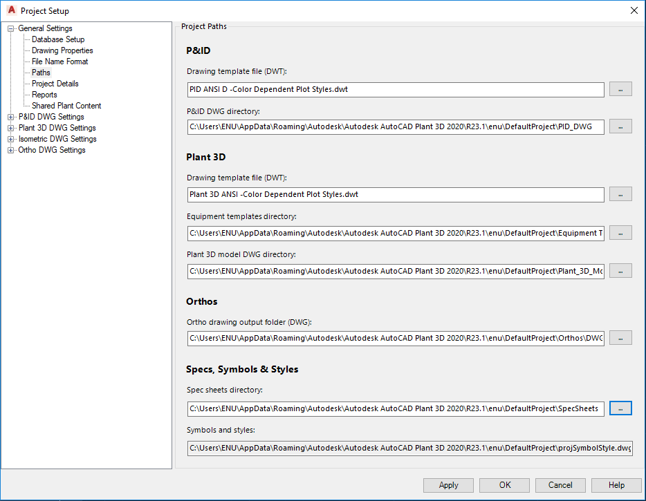

Paths (General Settings Tree Node)
Sets the paths and directories where users access symbols, reports, the project drawing directory, and so on.
P&ID
Defines the P&ID paths.
Drawing Template File (dwt)
Defines the template file that displays by default when users open a project. You can browse to select a different file.
P&ID DWG Directory
Sets the location of the project drawing directory. You can browse to set another location.
Plant 3D
Defines the Plant 3D project paths.
Drawing template file (DWT)
Sets the location of the project model template directory. You can browse to select another location or template.
Equipment template directory
Sets the location of the equipment template directory.
Plant 3D model DWG Directory
Sets the location of the project model directory. You can browse to set another location.
Orthos
Ortho drawing output folder (DWG)
Sets the location for ortho drawings. You can browse to select another location.
Specs, Symbols & Styles
Spec sheets directory
Sets the location of the spec sheets directory. You can browse to select another location.
Symbols and styles
Displays the location where symbols are stored. You cannot edit this location.
