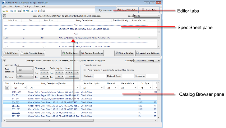

With the AutoCAD Plant 3D toolset Spec Editor, you can create and modify spec files using industry standard parts catalogs. You can also customize catalogs.
In the Spec Editor tab, you add components from the Catalog Browser pane to the Spec Sheet pane.
You can use the Editor tabs to switch between the following workspaces:
  • The Spec Editor
  • The Branch Table Editor
  • The Catalog Editor
Use the Spec Editor to add parts to a spec. Set branch fitting preferences used in AutoCAD Plant 3D toolset when routing pipe in the Branch Table Editor. Use the Catalog Editor to manage catalogs, modify the dimensional properties of piping components, and to create components.
