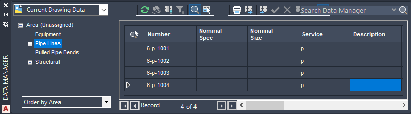

Note:
Exclusive project access is required to change the line number using Data Manager. Renaming a line number can modify more than one project drawing.
- On the ribbon, click Home tab > Project panel > Data Manager.
- In the Data Manager, in the drop-down list, click Current Drawing Data.
- In the Order By list, click Order by Area.
- In the tree view, expand Area. Click Pipe Lines.
- In the data view, double-click in the Tag column of the line number that you want to change.
- In the Assign Tag dialog box, in the box labeled Number, enter the line number (for example: 105).
- Click Assign.
