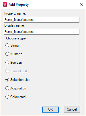

- On the Class Settings pane, under Properties, click Add.
- In the Add Property dialog box, do the following;
- Under Type, click Selection List.
- Under Property Name, enter a name for the new property (for example: Pump_Manufacturers). The name cannot contain any spaces.
- Under Display Name, enter the name you want to be displayed for the new property (for example: Pump Manufacturers) in the Data Manager or Properties palette.
- Click OK.

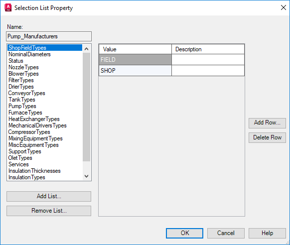

- In the Selection List Property dialog box, click Add List.
- In the Add Selection List dialog box, enter the name for the new selection list (for example: Manufacturers). Click OK.
- In the Selection List Property dialog box, click Add Row.
- In the Add Row dialog box, enter the new value (for example:
Goulds) and a description of the value, if necessary.
- Continue adding rows until the selection list is complete.
- Click OK.
