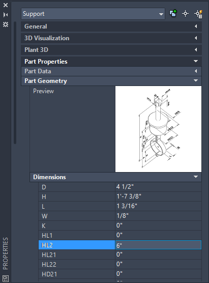

    To change pipe support dimensions
    1. In the drawing area, select a pipe support (for example: a Spring Hanger).
    2. Right-click in the drawing area. Click Properties.
    3. In the Properties palette, under Part Properties Part Geometry Dimensions, click a dimension value (for example: HL2).
    4. If you want to see dimension detail, click the preview image.
    5. In the dimension value box, enter a new value (for example: 6").
