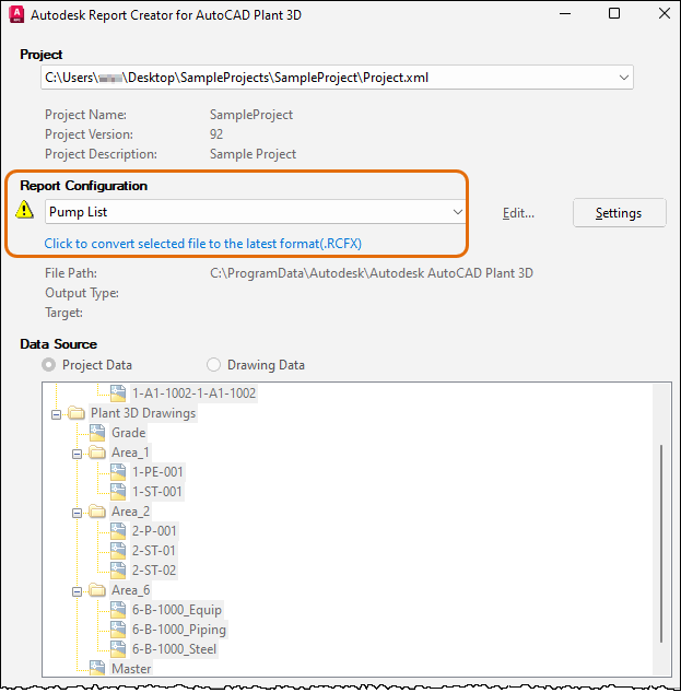

If you are using the 2024 version or earlier, the older rcf format is not compatible with the current version. To ensure compatibility with the Report Creator, you need to migrate any existing rcf files to rcfx format.
When you select a legacy report configuration file, a warning message is displayed. Follow the necessary steps to proceed.

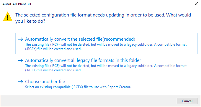

For handling legacy report configuration files, you have three options to choose from:
  • Convert the selected legacy file to the updated format file automatically. A legacy subfolder is created to store the original legacy file.
  • Convert all the legacy files to the updated format file automatically. Similar to the previous option, a legacy subfolder is created to store the original legacy files.
  • Exit the dialog box and go back to Report Configuration dialog box to choose an updated format file.
Note: The updated RCFX files are not compatible with AutoCAD Plant 3D 2024 version or any earlier versions.
