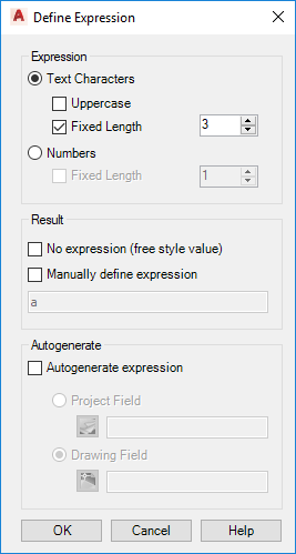

Define Expression Dialog Box (Tag Format Setup Dialog Box)
Sets tag expressions, results, and automatic generation details.
Expression
Defines tagging format expressions.
Text Characters
Displays tags as text characters, which can be displayed in uppercase letters and defined as a fixed length.
Numbers
Displays tags as numbers, which can be defined as a fixed length.
Result
Allows you to set an expression either in free-form or manually.
No Expression (Free Style Value)
Displays the tag in free-form.
Manually Define Expression
Displays a box where you enter the expression.
Autogenerate
Sets automatically generated expressions for project or drawing fields.
Autogenerate Expression
Enables the Project Field and Drawing Field options.
Project Field
Displays the Select Project Autogeneration Property dialog box.
Drawing Field
Displays the Select Drawing Autogeneration Property dialog box.
