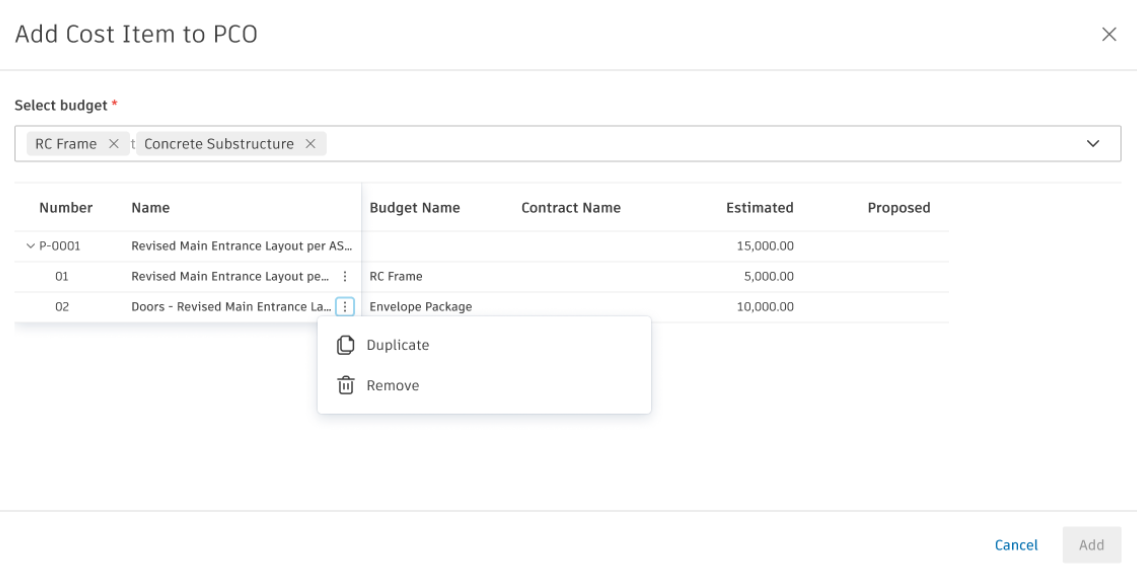

  9. Select the More menu More Menu Icon to add cost items, duplicate, change status, and more.
    Tip: You can create up to 100 cost items at once by choosing Batch create Cost Item.

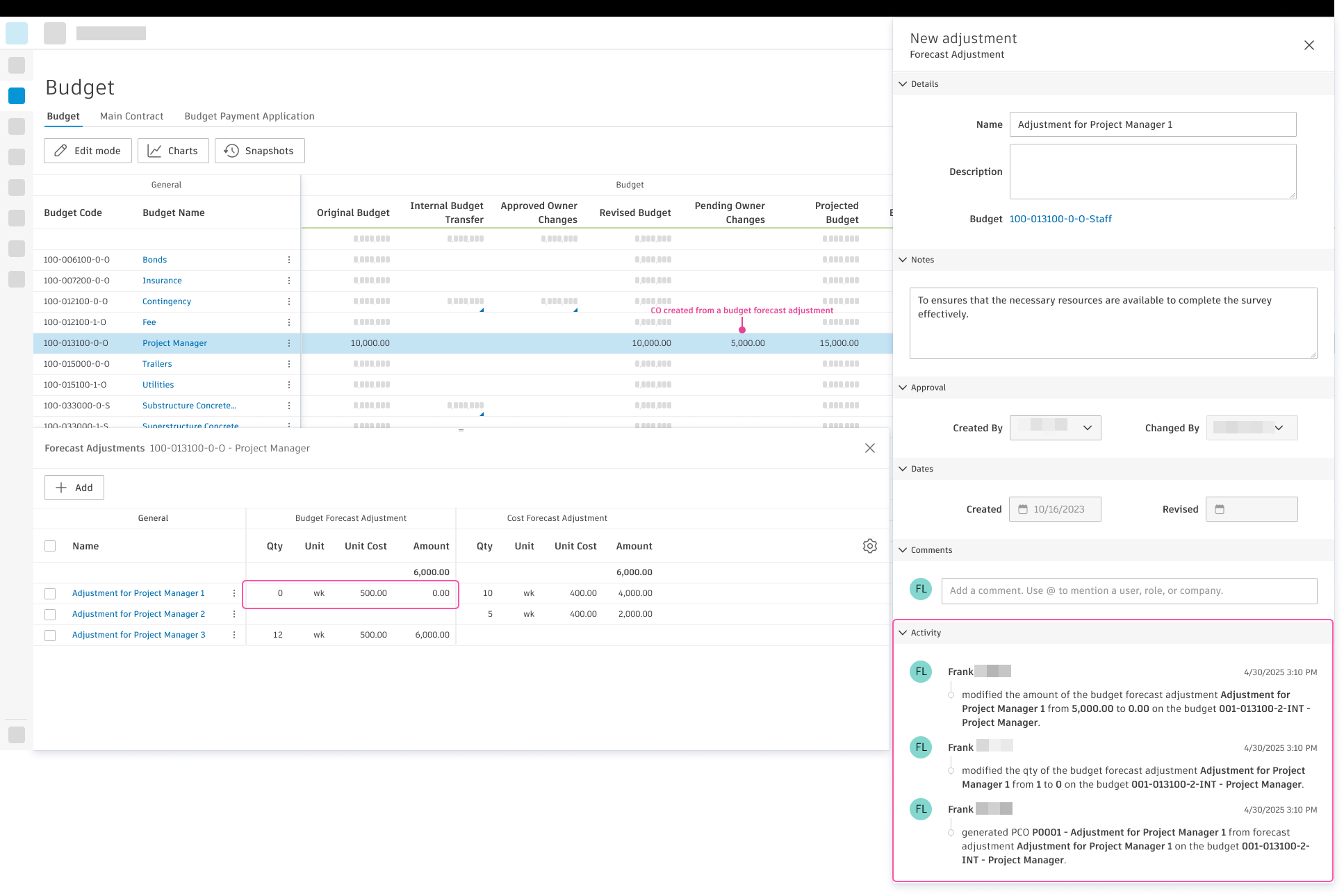

Create a PCO from Forecast Adjustment

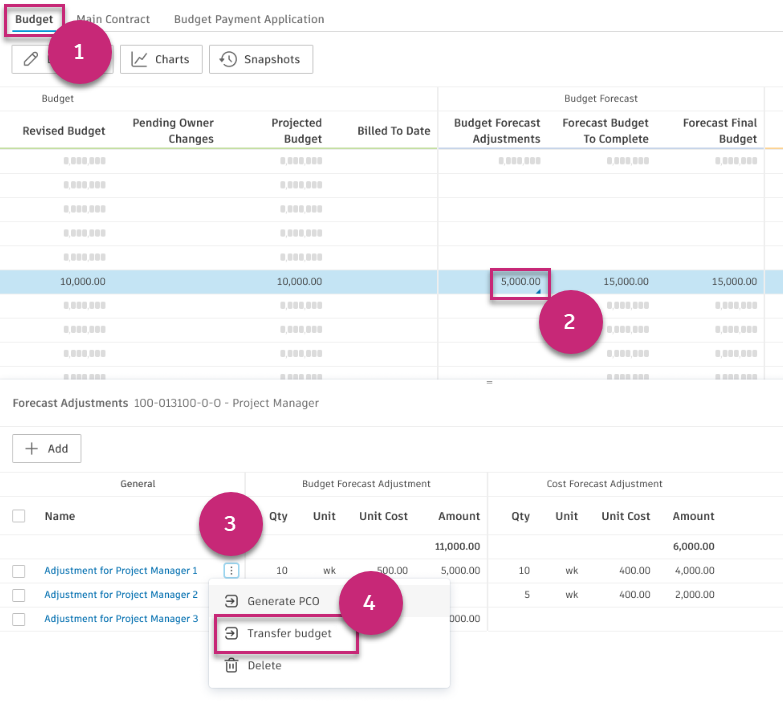

You can create a PCO from forecast adjustment to request additional budget. This can be done when project administrator set revenue forecast.
To do so:
  1. Open th Budget tab in Cost Management.
  2. Click the blue triangle in the Budget Forecast Adjustments column in the Budget Forecast section of the table. Those are visible if revenue forecast is on. The bottom flyout opens.
  3. Click the More menu More menu next to the forecast adjustment. Tip: You can also batch create PCOs from forecast adjustments. To do so, check all the boxes next to forecast adjustments in the bottom flyout and click Generate PCO.
  4. Choose Generate PCO.
Create PCO from forecast adjustments
Tip: Alternatively, you can follow the procedure from the details panel of the budget. To open details panel, just click the budget name and scroll down to Forecast Adjustments section.
The Generate PCO window opens. You can generate from budget forecast adjustment, cost forecast adjustment, or both.
Generate PCO from forecast adjustments
After the PCO is generated, you'll see changes in the Pending Owner Changes. If you generated from budget forecast adjustment, Budget Forecast Adjustment Qty is set to 0. As a result, Amount is also set to 0. Unit Cost is not changed. There are three activity logs after this procedure.
PCO from forecast adjustments - outcome
It's the similar rule for other options. If you generated PCO from cost forecast adjustment, you'll see changes in Cost Forecast Adjustment section and so on. If from both - you'll see changes in both places and there will be 5 activity logs.

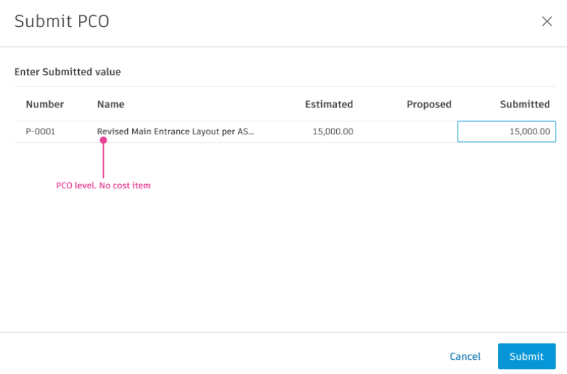

Submit PCO as COR Without Cost Items
When working with PCOs in an early estimation phase, you can submit a PCO for review without creating detailed cost items. This streamlines the workflow when you need to get budget approval quickly.
To submit a PCO without cost items:
  1. Create a PCO and enter values in the Estimated, Proposed, or Submitted columns at the PCO level.
  2. Click the More menu More menu icon next to the PCO.
  3. Choose Budget Change, then Submit.
    Submit PCO without cost items
  4. If there is no Submitted value, the Submit PCO modal will only show the PCO level. Enter the Submitted value and click Submit.
    Submit PCO modal
  5. If there is a Submitted value, the PCO as COR can also be submitted via the Send for signature action. Once the document is signed and returned, PCO as COR will be automatically set as accepted.
Tip: Estimated, Proposed, Submitted columns are editable on PCO level when no cost items are attached. This allows for flexibility in the early stages of change order processing.

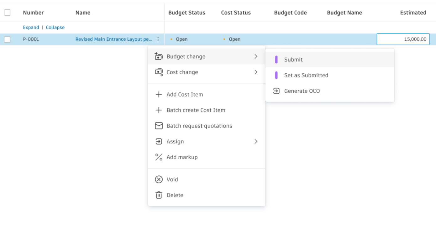

  1. Click the More menu More Menu Icon next to the PCO.
  2. If the scope of the PCO is:
    • In Scope - click Cost Change and choose Generate RFQ or Generate SCO.
    • Budget Only - click Budget Change to generate COR or OCO.
    • Out of Scope or Contingency - click Budget Change to generate COR or OCO and Cost Change to generate RFQ or SCO.
    Tip: To learn more about scopes and how change orders populate in the budget and contract tables, see the Budget and Contract Tables article.

Create an Internal Budget Transfer from PCO
Project administrators and members with both Budget and SCO full control permissions can create internal budget transfers directly from PCOs. This is useful when you need to move money from one budget item to another to pay for change orders without requiring extra approvals.
Tip: You can also create budget transfers directly from the Budget tool or from forecast adjustments.
To create a budget transfer from a PCO:
  1. Go to the Change Order tab and select the PCO tab.
  2. You can create a budget transfer in several ways:
    • From a PCO: Click the More menu Vertical more menu icon next to the PCO, click Budget change, and select Transfer budget.
    • From multiple items: Select multiple PCOs or cost items, then click Transfer budget in the batch actions.
      Batch transfer budget example
  3. Then, in Internal budget transfer:
    • Each selected cost item with a nonzero Committed value creates one transfer line.
    • For positive Committed values (money allocated), the system automatically uses the cost item's linked budget in the To field.
    • For negative Committed values (money being removed), the system automatically uses the cost item's linked budget in the From field.
    • The Amount is automatically set to the absolute value of the Committed amount.
    • A note is automatically added referencing the source cost item.
  4. Click Add Icon to add more transfers, even those that are not linked to the cost items. Those transfers are separated in the table.
  5. Click Delete Icon to delete a transfer from the list.
  6. You can use Copy to all "From" or Copy to all "To" buttons to quickly populate all transfer lines with the same budget.
    Copy to all "From" button example
  7. Click Save to create one or more internal budget transfers.
You'll receive confirmation that the budget transfer was completed.
Generate a Contract from a PCO
Before generating a contract, make sure that:
Then:
  2. Choose Cost Change.
  3. Click Generate Contract.
  4. Enter Contract Code and Contract Name. If the foreign currency setting is enabled in your project, you'll see the Currency and Exchange Rate fields as well.
    • Choose the currency for your new contract.
    • Edit the exchange rate if needed. The default exchange rate is fetched from the settings.
  5. Enter the committed value or copy it from the cost item. If the foreign currency setting is on, the Converted Icon icon shows the converted value.
  6. Click Generate.
Tip: Contract schedule of values will be generated from the Committed value and its breakdown of each Cost Item. If all cost items of a PCO have a status of Contracted or Approved, PCO cost status will move to Approved.

Add Cost Items to a PCO
While you can create and work with PCOs without cost items for initial estimates, certain actions require cost items to be added. The system will guide you through adding cost items when needed.
Cost items must be added to a PCO before you can:
  • Apply financial markup formulas
  • Generate change orders (RFQ, COR, OCO, SCO)
  • Generate contracts
Adding Cost Items
When you select Add Cost Item from the More More menu icon menu, the system displays a modal to help you add cost items:
  1. Select budgets from the budget picker.
  2. Choose the cost items you want to add to the PCO.
    Add cost item to PCO modal
  3. Click Add.
The first cost item you add will inherit the value from the PCO level, and the default cost item name will be copied from the PCO name.
If you attempt an action that requires cost items (such as applying markup or generating a change order) without having cost items attached, the system will display a modal prompting you to add cost items first with the message "Cost Item must be added before [action name]" and guides you through selecting the appropriate budgets and cost items.
Tip: When adding multiple cost items, ensure that the sum of the cost item values matches the PCO level value to maintain data consistency.
