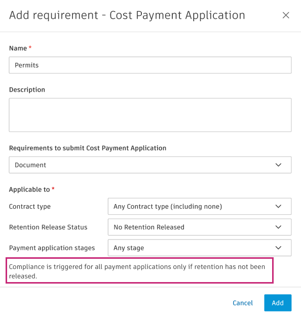

For Cost Payment Applications:
  1. Choose a document-based requirement. You can select an extra option Requires a document expiration date. See the Set Expiration Dates section in the Compliance Requirements article for more information.
  2. Specify aplicability for this requirement:
    • Contract type: You can choose if the requirement applies to one, several, none, or all contract types.
    • Retention release status: Choose between Any, Released, and Not Released. Learn more about retention release.
    • Payment application status: Choose the applicable stage: Initial, Progress, or Final. Learn more about payment applications' stages.
      You can create different sets of compliance for payment applications depending on the options you choose. A helpful note will appear, explaining how your choices affect the application. For example:
      Compliance payment note example
  3. Click Save.
