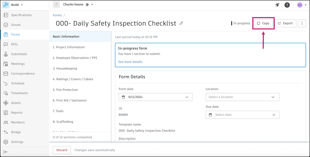

You must have Editor or Manager permissions. You can copy In progress, Closed, and Archived forms.
Navigate to the Forms tool.
Click the form that you want to copy.
Click Copy.
Confirm by clicking Copy in the dialog that appears.
Return to the Forms tab to see the copied form.
