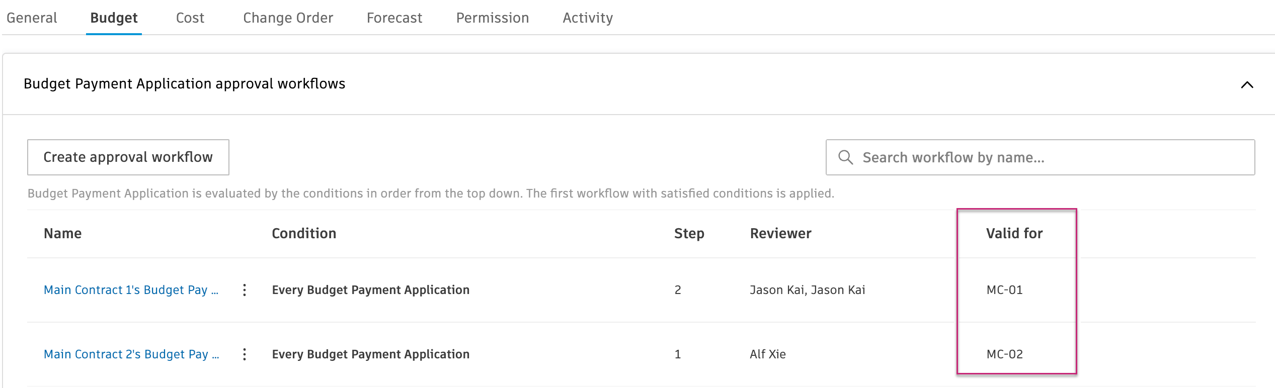

Configure Main Contract Conditions for Budget Payment Workflows
For budget payment applications, you can create multiple approval workflows based on different conditions, such as the main contract being used. This allows you to have different approval processes for different main contracts within the same project.
Budget payment applications are evaluated by the workflow conditions in order from the top down. The first workflow with satisfied conditions is applied to the payment application. The Valid for column in the workflow list shows which main contract each workflow applies to.
Budget payment workflow with valid for column

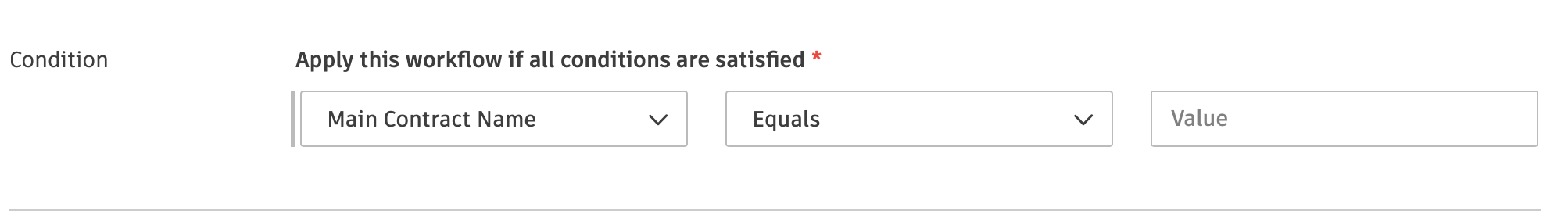

To configure a workflow based on main contract:
  1. Follow the steps in Create Approval Workflows to begin creating a budget payment application workflow.
  2. When setting conditions (step 7), select Main Contract Name from the first condition dropdown.
  3. Select Equals from the operator dropdown.
  4. Enter the main contract value in the Value field (for example, MC-01 or MC-02).
    Main contract condition configuration
    Note: By default, the field value is "Default Main Contract". During project copying from a template or source project, this value is reset to "Default Main Contract" since main contracts do not exist on the destination project yet.
  5. Complete the remaining workflow configuration steps and click Save.
The Valid for column will display the main contract code, making it easy to identify which workflow applies to which contract.
Tip: This feature eliminates the previous limitation of having only one approval workflow per project. You no longer need to manually move workflows to the top each time you want to change the active workflow. Instead, the system automatically applies the appropriate workflow based on the main contract selected in the payment application.
