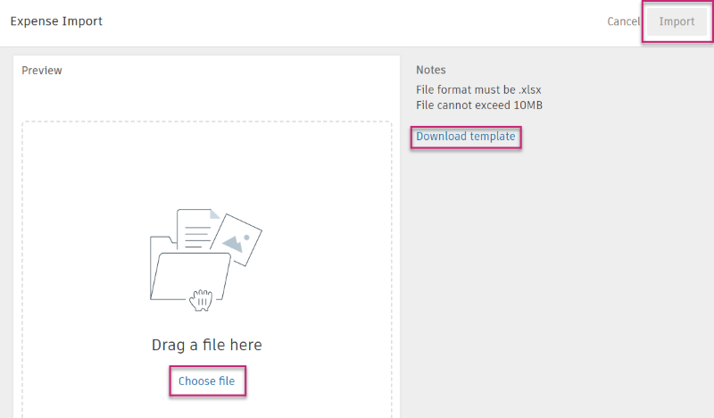

Add Expenses From a Spreadsheet
To add a list of expenses from an existing spreadsheet:
  1. In the Cost tab, select the Expense tab.
  2. Click Import button.
  3. Choose an Excel file to be imported.
    Import Excel file for expenses
    Note: You can use the example template to learn the correct formatting.
  4. Click Import, and then Done.
