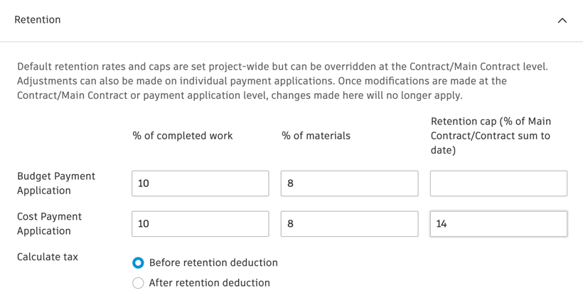

To set the retention rates:
  1. Click Module Selector Module selector iconArrow iconProject admin icon.
  2. Go to Services, then click Cost Management.
  3. On the General tab, click Retention.
  4. Enter the % of Completed Work, % of Materials Stored, and the Retention Cap for both the budget and cost payment applications.
  5. Choose to calculate the tax Before Retention Deduction or After Retention Deduction.
Cost retention settings
Tip: The retention rate can also be modified and overridden at the contract or main contract level.

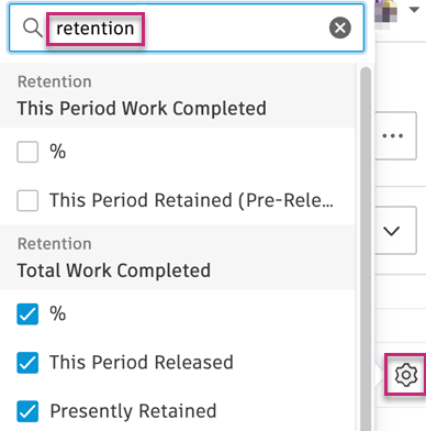

  1. Go to the Cost Payment Application or Budget Payment Application tab.
  2. Within the current billing period, adjust retention columns by clicking the Gear Icon icon.
  3. Type "Retention" and choose the corresponding retention-related columns.

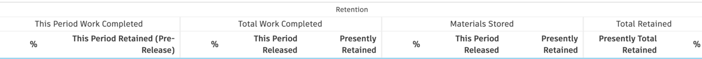

    Retention Columns
  4. Manually adjust This Period Work Completed Retention Percentage to the desired percentage for each payment item that you want to apply for retainage.
    Retention Columns Names
