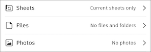

    Tool download options
    • Sheets: (Autodesk Build only)
      • Current sheets only: Download only the current set of sheets, for example to get ready for your site walk.
      • All sheets: Download all versions of all sheets.
      • No sheets.
    • Files:
      • All files and folders.
      • No files.
        Note: Files download options are available only the first time you download each project to your device.
    • Photos: (Autodesk Build only)
      • All photos.
      • Only photos created in the last seven, 14, 30, or 60 days.
      • No photos.
