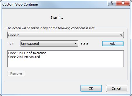

To create a Custom Stop Continue item:
  1. Click Measure tab > Items panel > Custom Stop Continue. The Custom Stop Continue dialog is displayed.
  2. In the All items list, select the item you want to test.
  3. In the State list, select the test you want to apply to the selected item.
  4. Click Add to create the test.
  5. Repeat steps 2 to 4 if you want to add more tests.
  6. Click OK to close the dialog and add the item to the inspection sequence.

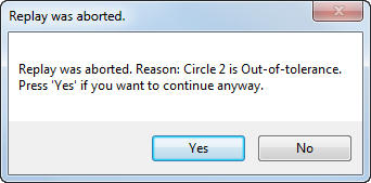

If any of the conditions is met when you run the item, processing stops and a message is displayed. For example:
