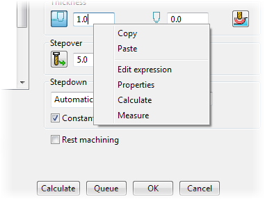

Right-click in a text field of a diaog to display the context menu.
Copy — Select to copy the value of the field onto the clipboard.
Paste — Select to paste the value from the clipboard into this field.
Edit expression — Select to display the Expression Editor toolbar so that you can create, edit, and calculate expressions.
Properties — Select to display information about the field. The dialog contains the following:
- Parameter name — The name of the parameter, which can be used in expressions.
- Expression — The value of the field, or the expression used to calculate the value.
- Widget name — The name used internally, which can be used in macros.
Calculate — Select to display the Standard Calculator dialog.
Measure — Select to display the Measuring Tools tab.
