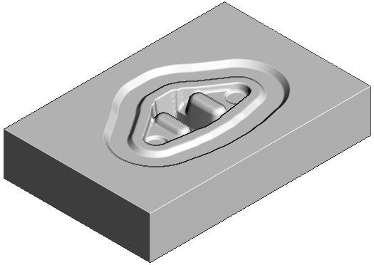

- Shading:
- Plain — Click to simulate using a high resolution plain-rendered image. It shades the part in a matt finish:

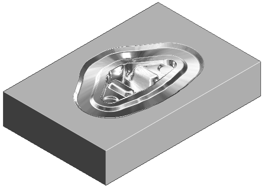

- Shiny — Click to simulate using a high resolution shiny-rendered image. It shades the part in a shiny finish:

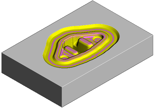

- Rainbow — Click to simulates using a high resolution rainbow-rendered image. It shades each successive toolpath in a different colour so you can see the effect of each toolpath on the part:

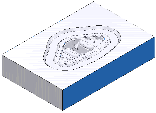

- Cut Direction — Click to simulate using a high resolution plain-rendered image. It shades the climb and conventional cuts in different colours:
