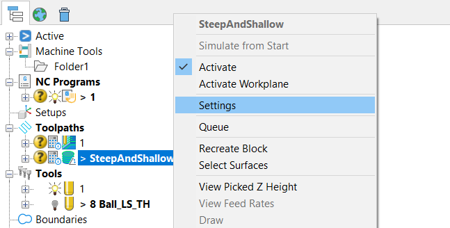

  1. In the Explorer, expand Toolpaths and select the SteepAndShallow toolpath.
  2. Right-click and select Settings from the context menu.

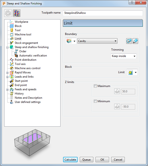

    1. Select the Limit page and:
      From the Boundary list, select Cavity.
      From the Trimming list, select Keep inside.

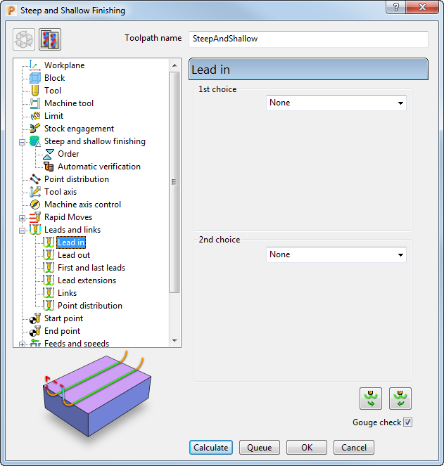

    2. Expand the Leads and Links page, select the Lead in sub-page and:
      In the 1st Choice list, select None.

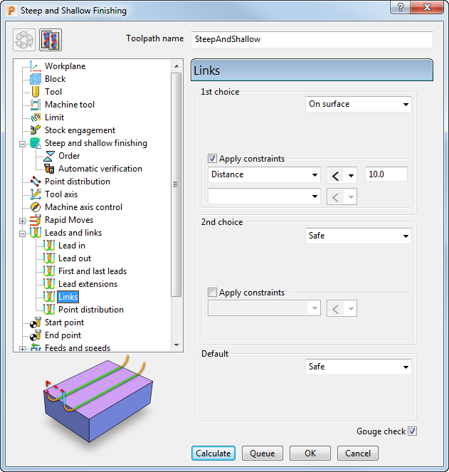

    3. Select the Links sub-page to define link moves between the cutting moves in the toolpath and:
      In the 1st choice list, select On surface to define the type of link moves used to connect adjacent passes.
