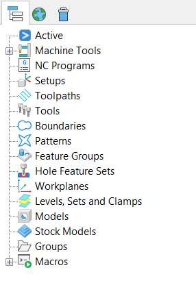

The Recycle Bin in the Explorer stores deleted PowerMill entities, (for example, toolpaths).
When you start PowerMill the Recycle Bin is empty.

Deleted entities in the Explorer are placed in the Recycle Bin.
In Recycle Bin, right-click an entity to view the available options.
