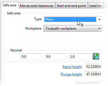

To display context-sensitive help for an item within a PowerMill dialog (such as a field or a button), click and when the cursor changes to , click the item to open the associated help topic:
