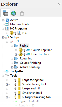

The Explorer displays the entities used in a PowerMill project. (The term entity broadly refers to all entries in the Explorer.) The entities in the Explorer are grouped together by type, for example, toolpaths are grouped in the Toolpaths branch and tools are grouped in the Tools branch. Because a PowerMill project often contains a lot of entities, the Explorer uses an Active system to indicate which entities have focus.
Making an entity active (shortcut)
Double-click an entity to make it active (you need to click the entity's icon and not its name). The new active entity is displayed in bold and proceeded by an angle bracket (>).
Each branch can only have one active entity at a time.

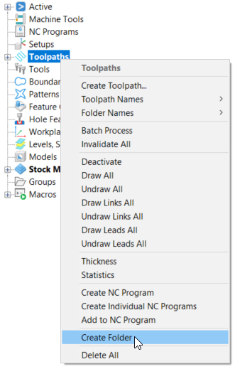

Creating a folder
You can create a folder within any of the Explorer entities, but they are probably of greatest use for organising tools and toolpaths.
Create Folder — Select to create a folder called Folder1. You can rename this folder in the normal way, and drag and drop entities of the particular type into the folder (for example, toolpaths into a toolpath folder).
