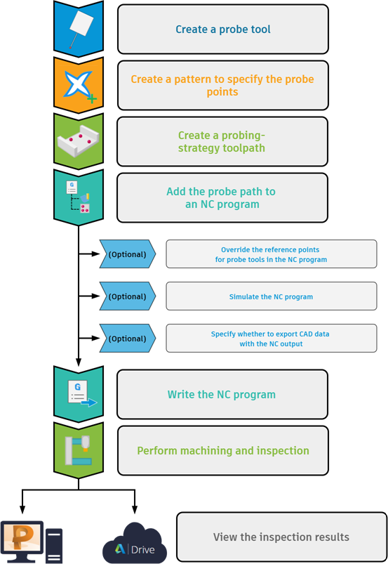

Share Email Facebook Twitter LinkedIn Workflow: Probing in PowerMill Follow these steps to create an inspection probe path and view the machine-generated results. Related Concepts Working with patternsTo add the active toolpath to selected entitiesSimulation Related Tasks To create a probe toolTo create a surface inspection probe-pathTo specify the probe-path output relative to the probe tip or probe centreTo export CAD data with the NC outputPostprocessing toolpathsWorking with the results of an inspection
