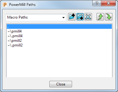

From the Macros menu select Macro Paths.
Alternatively, click File tab > Options > Customise Paths.
The PowerMill Paths dialog is displayed showing you all the default macro paths. PowerMill automatically searches for macros located within these folders, and displays them in the Explorer.
The period (.) indicates the path to the local folder (currently the folder to which the project is saved). The tilde (~) indicates your Home directory.
To create a macro path, click
, and use the Select Path dialog to select the desired location. The path is added to the top of the list.To change the path order, select the path you want to move, and use the
and
buttons to promote or demote the path.Click Close.
To load the new paths into PowerMill, expand the Macros branch in the Explorer. Only the paths that contain at least one macro are shown.
