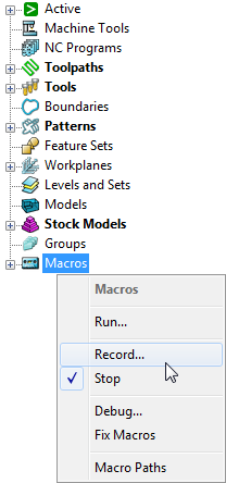

To record a macro:
  1. From the Macros context menu, select Record.
    This displays the Select Record Macro File dialog which is a standard Windows Save dialog.
  2. Move to the appropriate directory, enter an appropriate File name and click Save.
    The macro icon image changes to red to show recording is in progress.
    All dialog options that you want to include in your macro must be selected during its recording. If an option already has the desired value, re-enter it.
  3. Work through the set of commands you want to record.
  4. From the Macros context menu, select Stop to finish recording.
