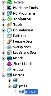

  5. From the Macros context menu, select Stop to finish recording.
  6. Expand the Macros node. The pmuser.mac macro is added under pmill4.
