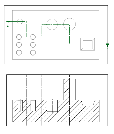

To create a stepped section line:
- Click Draft tab > View panel > Section.
- Click OK on the Information dialog to display the Section Line toolbar:
- Choose the mode for creating the section line:
- Select the Set feature recognition
button to create a section line through features. - Deselect the Set feature recognition
button to create a section line through points.
You can create a stepped section line to include features, points or a combination of both.

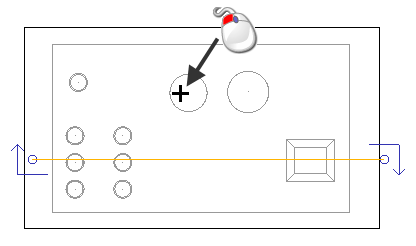

- Click to create a point or click on a feature in the view to create a section line:

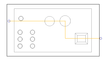

- Click on another feature or create another point to create a step in the section line:
The section line is drawn and steps automatically through each feature or point selected:
- Continue to click on other features or points as required to create the stepped section line.
- Click
to accept the changes and close the toolbar. Section view creation is started automatically, ready for you to place the section view in position on the drawing; as shown in the example below:
