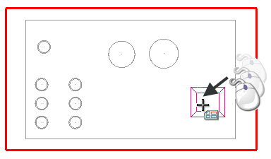

    • Deselect the Set feature recognition button to create a section line through points.
      In point mode, features are not recognized. Click in the view to specify a point:
      A section line is created through the point:
