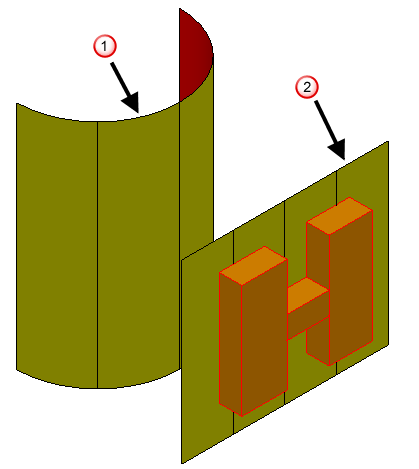

The following example shows how selected objects are morphed using the two-surface morphing method.
The morph is defined by:
Control surface
Reference surface
The extruded H surface is morphed by the difference between the flat reference surface and the cylindrical control surface. For each point on the reference surface, there is a corresponding point with the same 2D parametric coordinates on the control surface. This is used to define how to reshape the H.
