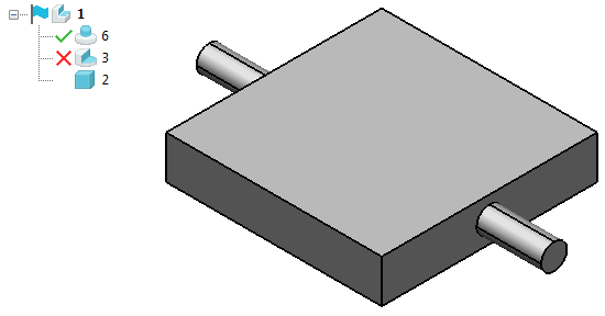

You can suppress a feature to remove it from the solid. PowerShape remembers the details of the suppressed feature.
To suppress a feature:
  1. Double-click the solid to display the solid feature tree, if the tree is not already displayed.
  2. Click the Unsuppressed feature icon .
  3. The icon changes to the Suppressed feature icon to indicate that the feature is now suppressed.
In the example below, we will suppress the cut feature.
The feature is removed from the solid.
To unsuppress a feature, click the Suppressed feature icon in the solid feature tree. The icon changes back to the Unsuppressed feature icon and the feature is visible on the solid again.
