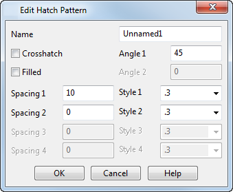

Edit Hatch Pattern dialog
Use this dialog to create or edit a hatch pattern.
  • Name — Enter the name of the hatch pattern.
  • Crosshatch — Select this option to create a cross hatch.
  • Filled — Select this option to create a filled hatch.
  • Angle — Enter the angle, measured from the X axis. For example:
    • Angle 1 — Enter the angle of the hatch lines.
    • Angle 2 — Enter the angle of the second hatch lines.
    Note: You must select the Crosshatch option to access this option.
    Both Angle 1 and Angle 2 are measured from the X axis:
  • Spacing — Enter the distance between the hatch lines.
  • Style — Select the style for each hatch line.
  • OK — Click this button to create or edit the hatch and close the dialog.
See Creating hatching for details on how to add the hatch to the model.
