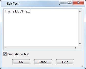

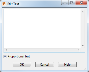

  3. Click a position on the screen to display the Edit Text dialog:
  4. Type the text in the dialog.
  5. Select the Proportional text option to create text that is proportionally spaced.
    If this option is deselected, the text is created using a fixed width.
  6. Click OK or click on the screen.

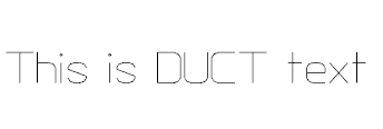

    The text is drawn on the screen:

  1. Double-click the text to display the Edit Text dialog.
    The selected text is displayed in the dialog:
  2. Edit the text in the dialog, for example change the words to:

  3. Click OK or click in the graphics window. The text is altered:
