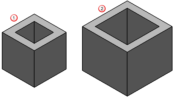

  6. Select the Offset Inwards option to offset faces inwards , or deselect this option to offset faces outwards :
  7. Select the Fillet Edges option to round the corners. If faces are offset outwards, each face has the same offset value:
