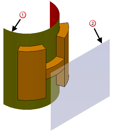

When the dialog is displayed, the following are shown:
Control surface.
Reference surface. In wireframe mode, the reference surface is drawn using dotted lines. In shaded mode, it is drawn in a transparent material.
If a decay curve or surface is used in the morph definition, it is also drawn as a dotted line. In shaded mode, the decay surfaces are shaded in a transparent material.

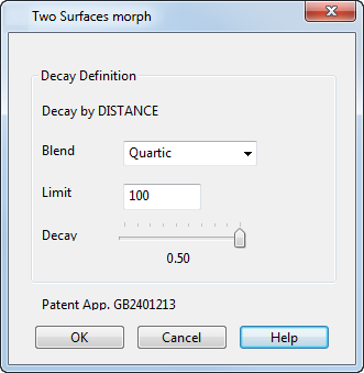

The Decay Definition can only be edited if it was defined when you created the morph. The method cannot be changed.
  • For Curve and Surface decays, you can only change the blend. The selected objects cannot be changed.
  • For the Distance method, you can change the blend, limit and decay scale.
The Decay options appear on the Surface Morphing dialog — Two Surfaces.
