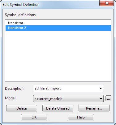

  1. Click Annotation tab > Symbol panel > Definition > Edit to display the Edit Symbol Definition dialog:
  2. Use the dialog to edit the symbol definition:
    • Symbol definitions — Click the symbol definition you want to edit. To deselect a symbol definition, click the name again.
    • Description — Enter or select a description for the selected definitions.
    • Model — Select the model from which you want to edit a symbol definition.
      To browse for symbol libraries from outside the model database, click to display the Open Library dialog. Use this to select a symbol library.
    • Delete — Deletes the selected symbol definitions, providing they are not used in the selected model.
    • Delete Unused — Deletes unused symbol definitions.
      Component definitions are not affected.
    • Rename — Displays the Rename Symbol Definition dialog:
      The dialog displays the current name of the selected symbol definition. Edit the name as required.
    • OK — Accepts any changes and closes the dialog.
