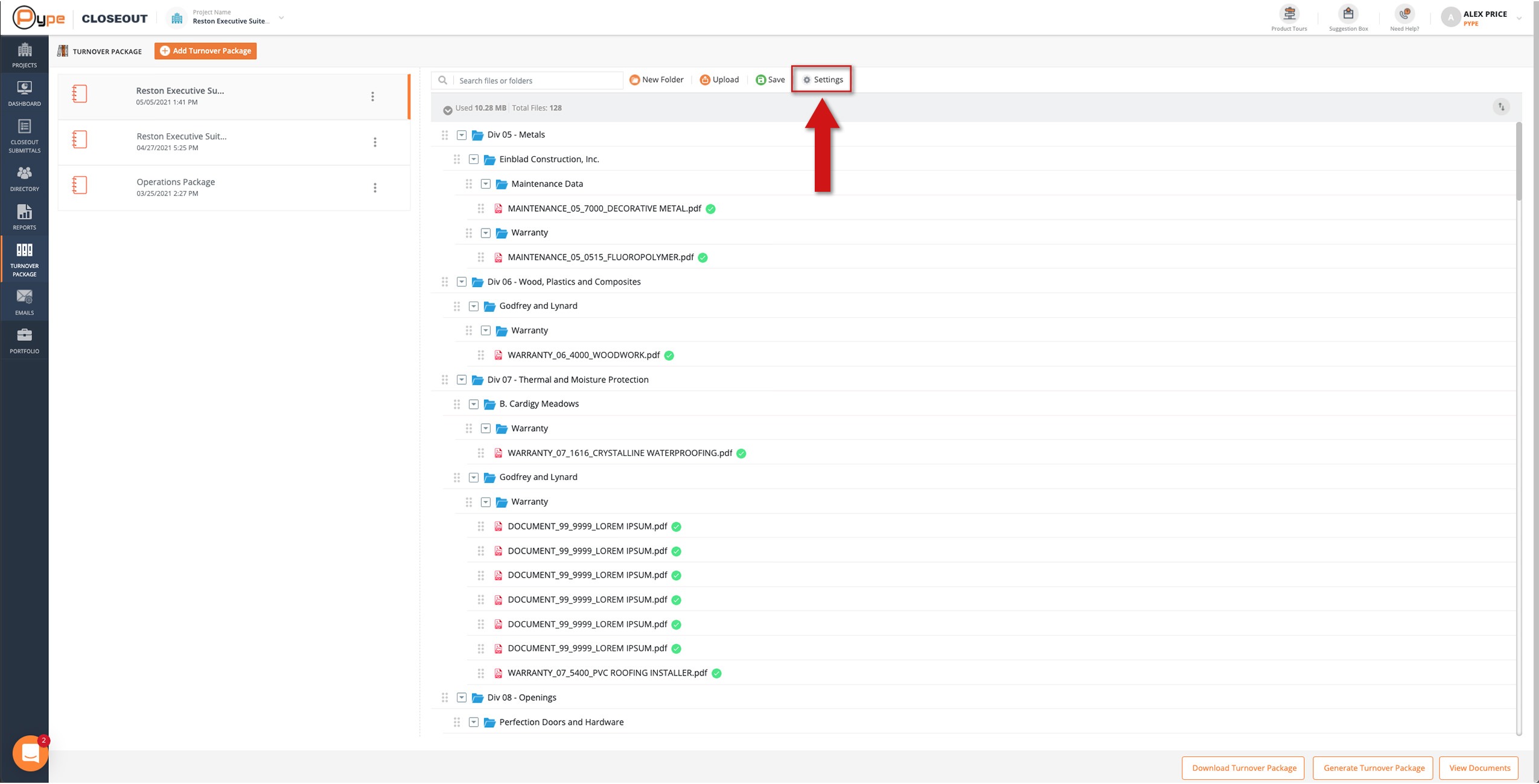

To customize the design of the cover page, table of contents, and/or slip sheets of a created turnover package, select the package from the left and then select the settings icon.

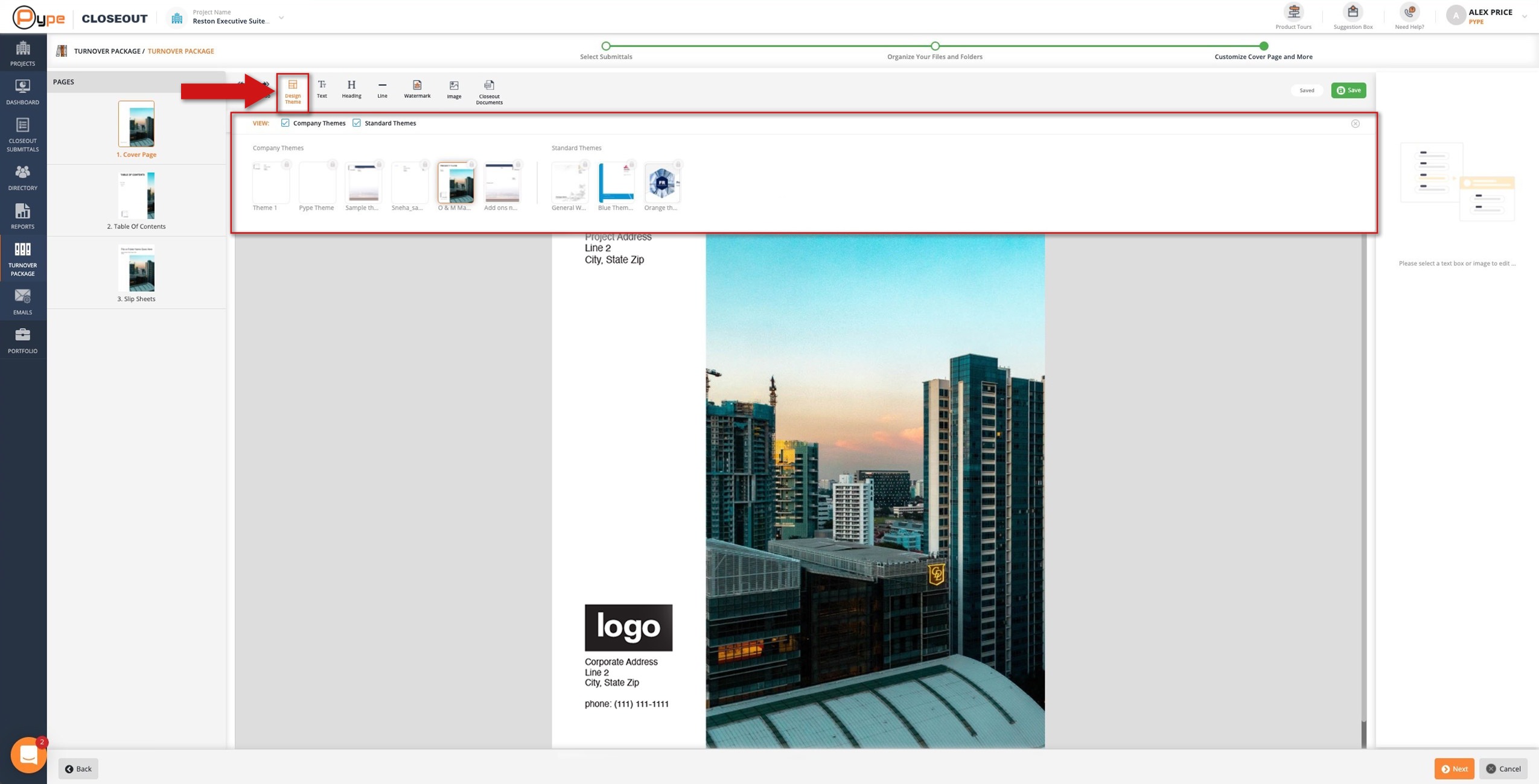

To convert your entire package to an existing theme, select Design Theme and choose which theme you want to use. Company admins are able to create new themes for their organization. Read this article for more information.

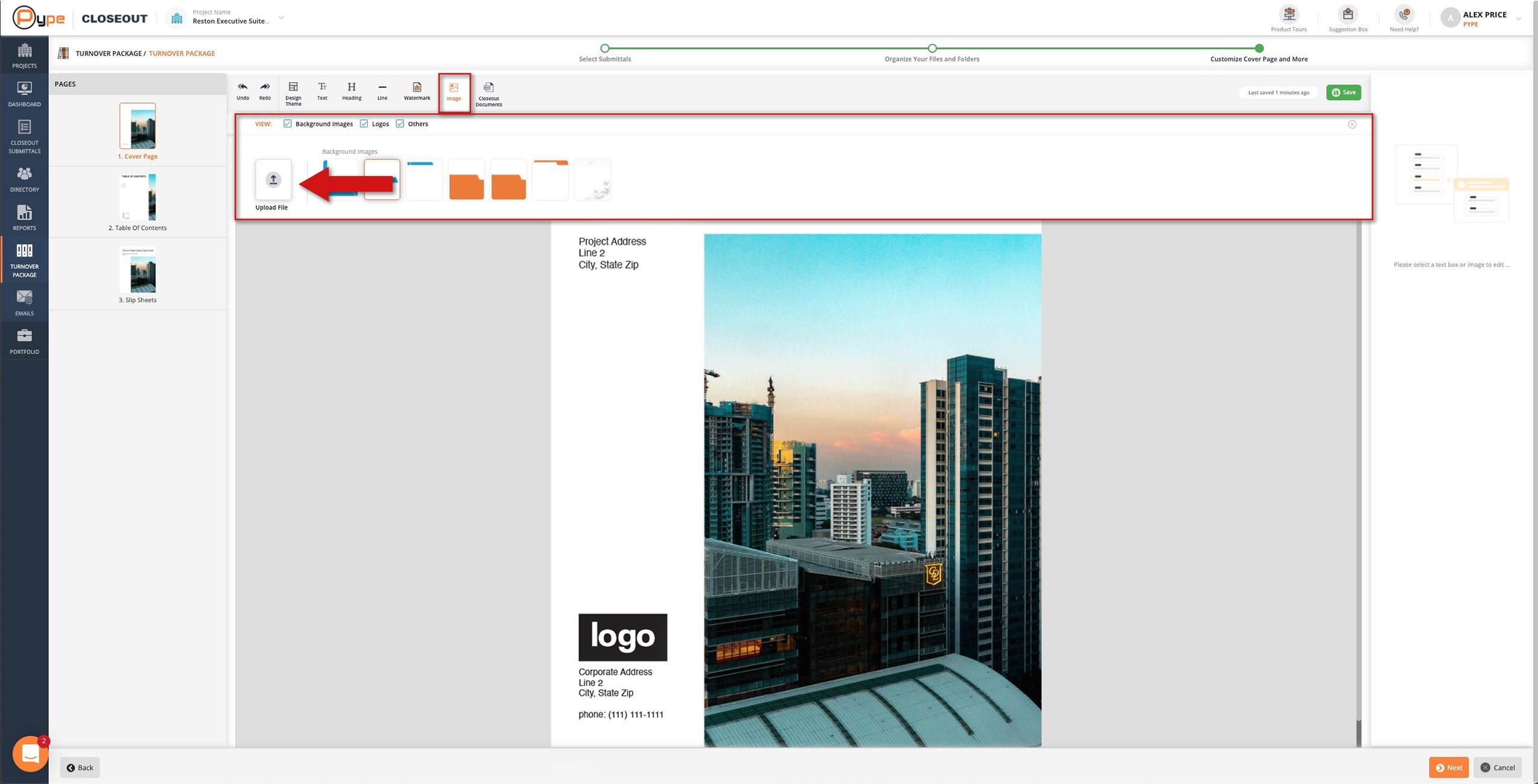

To add an image, select Image from the top and click on an image to add it to the page.
Select Upload File to add a new image from your computer. You will be asked to name the file and select a category. NOTE: Background images can only be used as a background

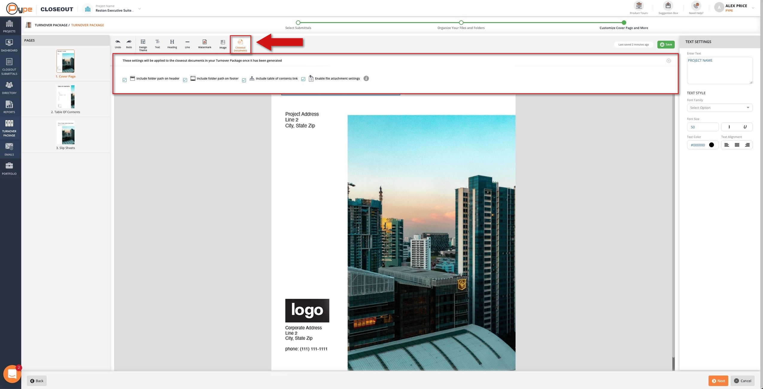

Closeout Documents includes the settings for links to be included on every page of your documents.
-Include Folder Path on Header: includes the folder path at the top of each page. -Include Folder Path on Footer: includes the folder path at the bottom of each page. -Include Table of Contents Link: includes a hyperlink back to the table of contents at the top of each page. -Enable File attachment settings: includes any non-PDF files in your package as downloadable attachments.

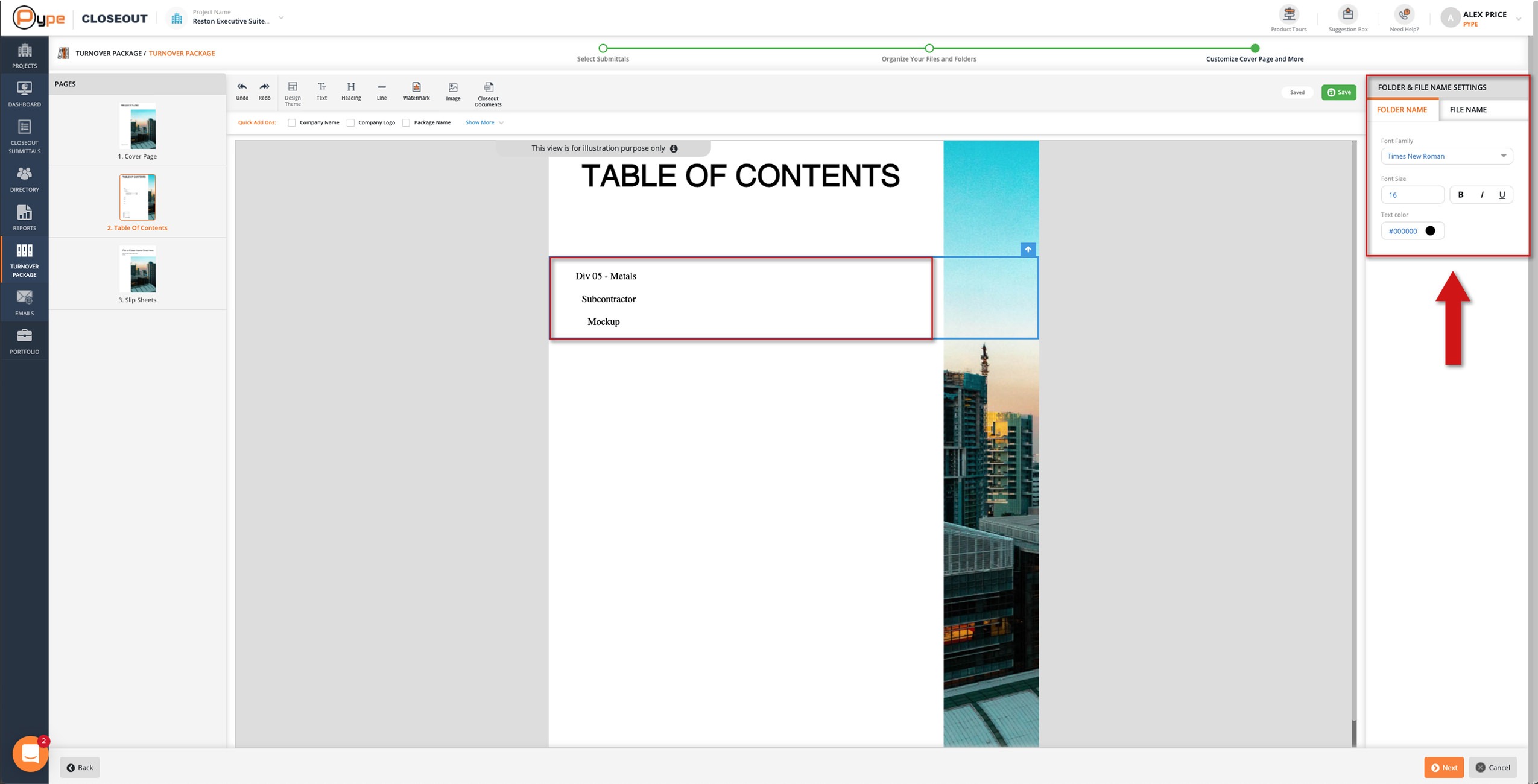

Table of Contents
The Table of Contents page is a sample with placeholder names and is a preview of what the full table of contents will look like once your package is generated.
Here you can customize the text style such as color, font, and size. Select the table of contents box and use the tools in the right column to make adjustments.

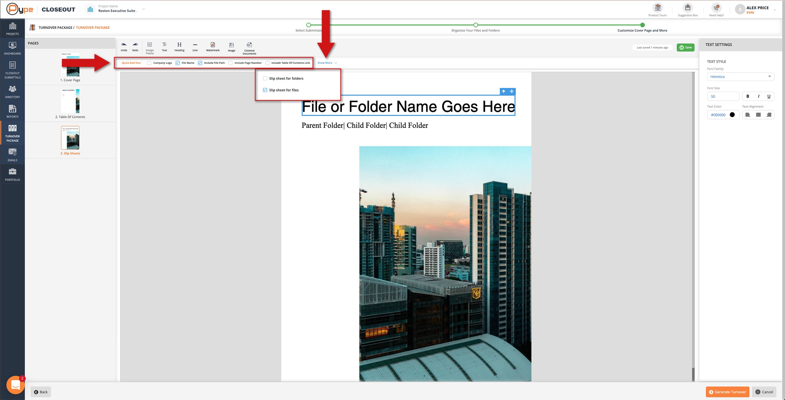

Slip Sheets
Slip sheets are the pages that will be inserted between your documents in the final package. You can customize your slip sheets using the same tools described above.
There are quick add ons for your slip sheets to easily add important information to these pages.
