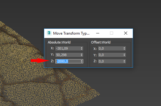

Reset Point Cloud Transformation in 3ds Max
  1. Load the point cloud into 3ds Max by following the instructions in this article: How to render Point Clouds in 3ds Max 2018 and more recent versions.
  2. Select the point cloud object in the scene graph.
  3. Click in the viewport and press the "F" key for flying to the object.
  4. Right-mouse-click on the point cloud and chose the options icon next to Move.
User-added image
  1. Enter a value to transform the point cloud up or down to the origin on the height axis, depending on the units and axis setup:
User-added image

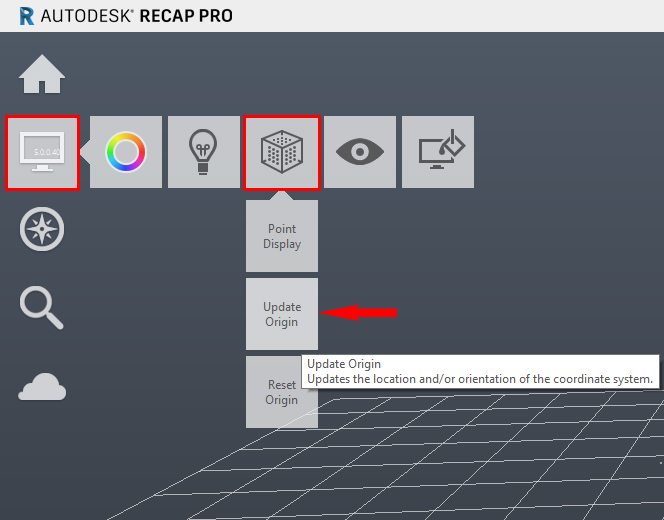

Reset Point Cloud Transformation in ReCap
  1. Start ReCap and load the RCP (ReCap Project) file.
  2. Click the monitor icon on the left side.
  3. At the roll-out menu, click the point icon and chose Update Origin.
User-added image
  1. Click the part of the scan that should be in the origin (the area will be highlighted with a yellow sphere) and confirm with Enter.
  2. By confirming with Enter, the yellow sphere on the scan will be in the 0/0/0 location
  3. Export the scan and then import the point cloud in 3ds Max as usual.
