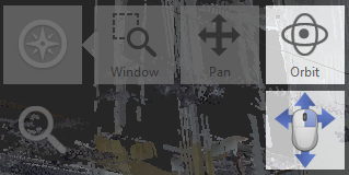

 Orbiting
Changes the orientation of the scene without changing your perceived distance from it.
Accessed by: Hotkey X
3-Button Mouse: Click to establish the pivot point, and hold down the right mouse button as you drag.
Navigation tile menu: Click Navigation → Orbit. Click to establish a pivot point and drag to change the orientation of the scene.
Press Alt+right mouse button as you drag to rotate, or tilt, the view of an axis that is perpendicular to the plane represented by the screen by pressing n.

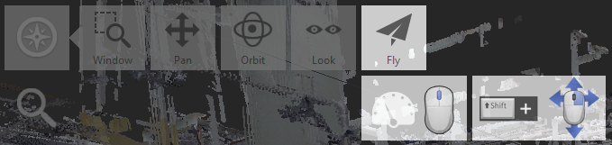

 Fly Navigation
Moves the viewpoint through the point cloud.
Accessed by: Hotkey C (toggles between Fly and Look)
3-Button Mouse: Hold down Shift+right mouse button. When the Walk/Fly cursor is displayed, drag in the direction you want to move to get the movement started. A direction cursor (such as north, southeast, west) indicates the direction of the movement. Continue to hold Shift+right mouse button until you have finished the fly-through.
Navigation tile menu: Click Navigation → Fly. Drag in the direction you want to move to get the movement started. A direction cursor indicates the direction of the movement. Continue to hold down the mouse button until you have finished the fly-through.

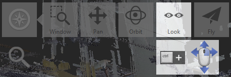

 Look Navigation
Moves the scene around a fixed viewpoint.
Accessed by:
Hotkey: I (toggles between Fly and Look)
3-Button Mouse: Hold down Ctrl+right mouse button as you drag in the direction that you want to look.
Click Navigation → Look. Drag in the direction that you want to look.
