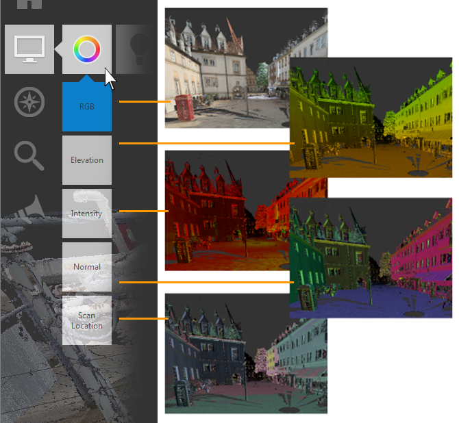

There are several ways to view your point cloud and gather information from it. Some methods, such as specifying color modes, provide information about the point cloud surfaces and elevations.
Realistic Display
Display points in the real-world colors originally captured by a camera built into the scanner. This color is based on RGB (red, green, blue) color values.

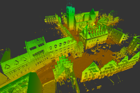

Elevation
Display point colors that reflect height, or z coordinates.

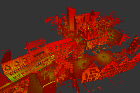

Display Intensity by Color
Set point display to show intensity, which measures point reflectivity based on surface texture, surface angle, and the environment.

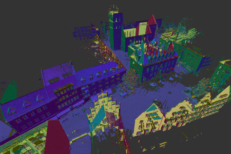

Display Point Normals by Color
Display points with colors assigned to the x, y, z values associated with the direction of the normal for the point.

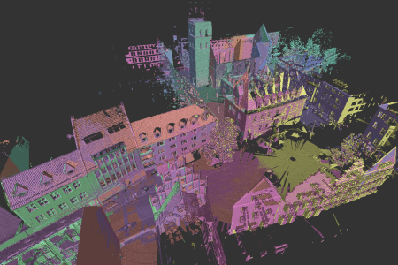

Display Scan Locations by Color
Display the point cloud with each scan location differentiated by color.

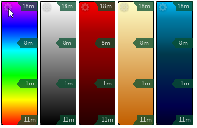

Gradient Ramps
The Gradient Ramp is displayed on the left-hand side of the viewer when you view a point cloud in the Elevation or Intensity color modes.
  1. Elevation
  2. Intensity
Depending on the current color mode, the colors convey information such as height, normal directions, or original scan locations. You can modify the number of colors on the Gradient Ramps, specify whether the colors are blended or distinct, or set them to use one of several color gradients such as grayscale, reds, earth tones, or blues.

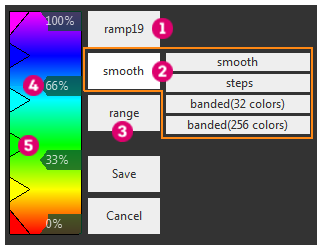

Once you’ve got the Settings dialog up, you’ll be able to adjust a number of variables associated with the current Gradient Ramp. These include selecting other default color spectrums, adding colors to the current spectrum, removing colors from the current spectrum, adjusting the point range, and altering the blend.
  1. Current color ramp name
  2. Specifies blended or distinct colors
  3. Adjusts point range
  4. Label
  5. Color node

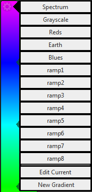

Set the Color Ramp to a Preset Color
You can set the Spectrum (the default) to a preset option. These include grayscale, reds, earth tones, or blues.

The ramp can be adjusted to alter the way the colors are displayed along the gradient. Smooth blends the colors along the ramp while any one of the 32-step, 64-step, or 256-step settings split the ramp into individual colors.
Edit Range for Intensity, Color, and Points
Click edit current gradient from the Settings icon:
