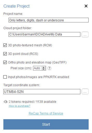

Automatic Pixel Size (GSD) Calculation for Ortho Photos (2023)
ReCap Photo has added support for automatic calculation the Pixel Size or Ground Sampling Distance for Ortho Photos based on the source images.
The user can still specify their own GSD value, but it will be ignored if specified lower than the value calculated from the source images.
Auto: GSD value is calculated and used from the source images.
A User specified GSD will be ignored if the GSD value calculated from the source images is higher
