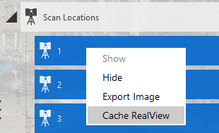

You can right click on scan locations and choose Cache RealView. This will cache the overview map and RealView files needed for optimized RealView viewing experience. You can also copy the overview maps (.png) and RealView cache files (.rch) found in Temporary Cache Files folder to Autodesk Connected Drive for RealView viewing in web browser.

- In ReCap, select all scan locations of interest (use SHIFT and/or CTRL to select multiple scans)
- Right click and choose Cache RealView. This will generate overview maps (.png) and RealView cache files (.rch) which can be found in < project_name > Support\Temporary Cache Files.
