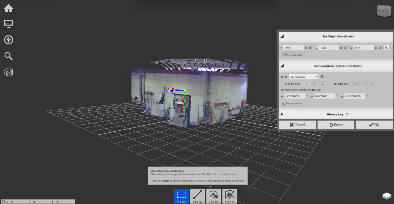

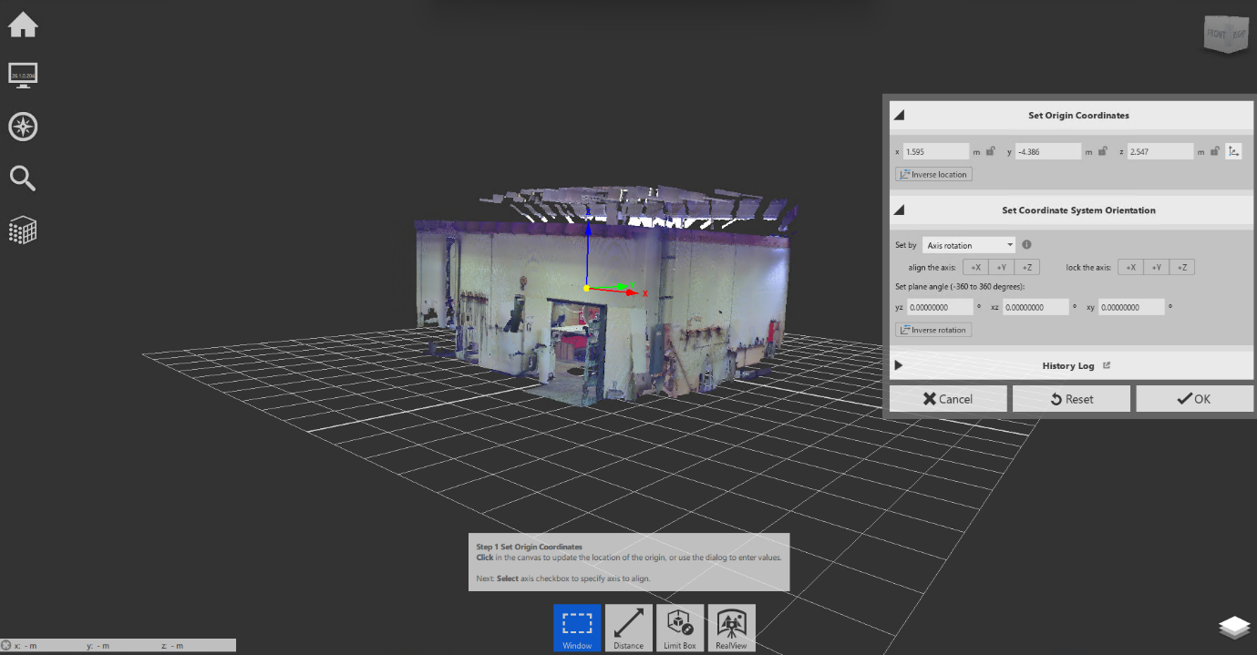

Before flip – axis arrow in default direction
After flip – axis arrow reversed
Flipping in Guideline Mode
