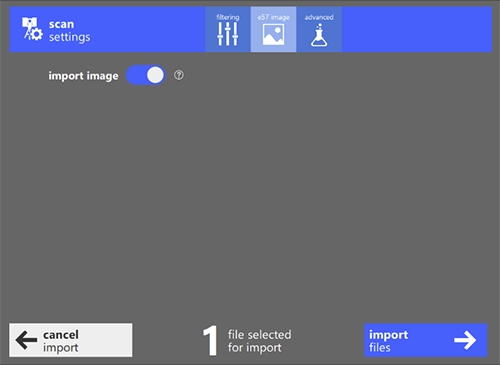

When importing an e57 file that contains 1 panorama image for each scan, do the following.
  1. Import the e57 file. The Scan Settings dialog displays.
  1. Enable "Import Image" to use e57 image data when the RealView is generated.
    Note: When "Import Image" is disabled, the point cloud imports as it is.
  2. Click Import Files.
